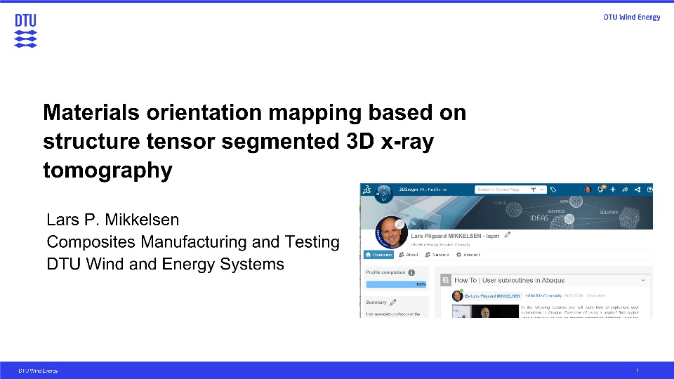

You can below find my shared presentation, including links to python based notebooks for performing and mapping structure tensor segmentation of 3D x-ray scan to Abaqus models using the orient.f user subroutine.
