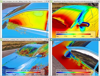

PPS Blue automates analysis and generation of rendered visualizations from PowerFLOW simulations. Operating as a suite of scripts, PPS Blue generates content for analysis and visualization by orchestrating PowerACOUSTICS and PowerVIZ in general and specifically caters to analysis of Aeroacoustic and DigitalROCK solutions. The current release is towards leveraging and supporting enhancements in the PowerFLOW and PowerACOUSTICS release 6-2019 for Aeroacoustics.
PPS Blue functions as a system of scripts that works in unison with PowerFLOW suite in Linux. PPS Blue does not require any scripting knowledge and uses a text based input method to function. Complete description on the key components of the PPS Blue, installations directions, usage modes (local and SIMULIA Cloud) and input descriptors is provided in the user guides included in the download.
It is strongly recommended to use this version with PowerFLOW 6-2019 (and above). Simulations run with prior PowerFLOW versions can continue with prior release (rel_2_8) and the upgrade is optional.
3.0 Release highlights:

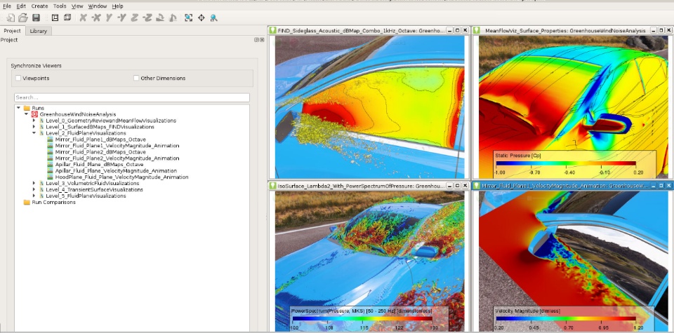

  • Generation of results in PowerINSIGHT compatible format for an improved browsing experience.
  • FIND Contributions calculation and analysis are now available in PPS Blue.
  • Part-by-part integration for FIND and FIND Contributions is compatible with the Integration Volume capability in PowerVIZ .
  • Part-by-part integration results are automatically exported in SPL file format for browsing in PowerACOUSTICS.
