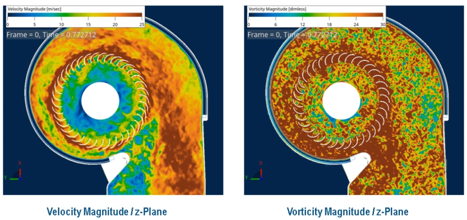

A deeper aerodynamic analysis provided meaningful insights of the flow paths through the cooktop extractor. This analysis highlighted regions of high velocity and vorticity concentration, possibly leading to noise source generation and subsequent propagation
