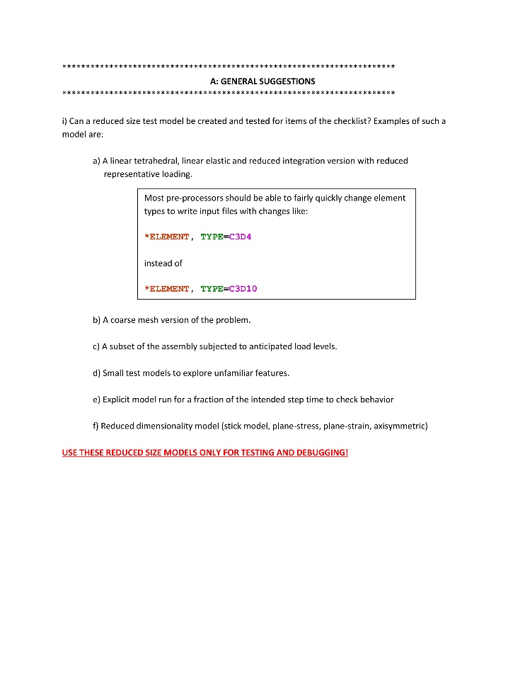

    • Scoping calculations with simplified models
    • Pre-analysis techniques to prevent non-convergence

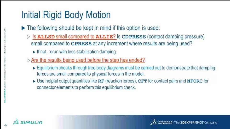

    • Appropriate uses of stabilization techniques

Here you will find a .pdf copy of the general Abaqus checklist:
