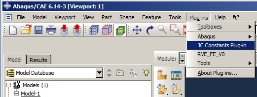

There is a native material model in Abaqus, called the Johnson-Cook model, that looks similar to the Ludwik power-law equation. In fact, the Johnson-Cook material model is a super-set of the Ludwik equation. We have developed an Abaqus/CAE plug-in to determine the Johnson-Cook power-law parameters from standard handbook data. A zip file is attached and you can put these files in your "abaqus_plugins" directory. With the plug-in installed, you will see a plug-in named "JC Constants Plug-in", as shown in the image below.

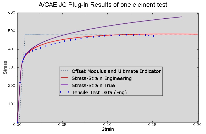

If you press the "Yes" button, the plug-in runs a one-element model using this Johnson-Cook material and plots the stress-strain response.
