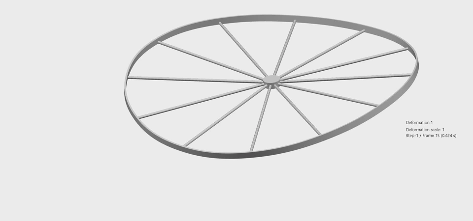

Potato chip
The video shows a two-step Abaqus/Standard simulation. The spokes are tensioned in step 1 from an initial stress. The structure contracts in step 2 when the temperature is lowered. One spoke contracts less than the others. The initial shape is seeded with an imperfection from a buckling analysis (*BUCKLE). The MP4 animation was made in the Physics Results Explorer app.
