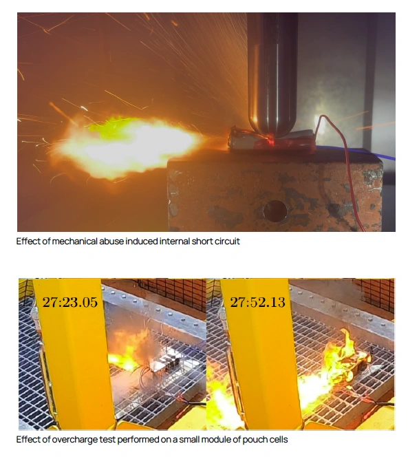

Crashworthiness should be regarded as a key requirement in the design of eVTOL aircraft, yet its inclusion in early design stages is challenging due to the need for rapid iteration and the complexity of large design domains. To address this issue, this work introduces an Abaqus/Explicit framework based on computationally efficient Finite Element/Multi-Body models of ATDs, seats, and the airframe, enabling fast parametric assessment of crash performance. Within this framework, a homogenized battery pack model, developed through a dedicated campaign of mechanical abuse experiments on cylindrical lithium-ion cells, is implemented to enable realistic yet efficient system-level crash simulations.
The framework is applied to a benchmark scenario, an 8 m/s vertical impact on rigid ground, considering multiple input parameters and performance metrics related to occupant survivability, structural loading, and battery pack deceleration. The adopted battery modeling strategy enables consistent evaluation of its mechanical response in full-scale simulations while preserving computational efficiency. In this context, the safety of lithium-ion batteries is numerically assessed under a variety of crash conditions, with particular attention to potential hazards associated with internal short circuits.
