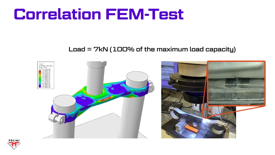

The department's activities integrate CAD development, numerical analyses and simulations, component assembly and experimental testing, with the goal of ensuring high mechanical performance, structural reliability and overall weight reduction. In this context, the project analyses the failure of a steering plate made of carbon fiber and aluminum, through a combined approach integrating experimental testing and finite element modeling (FEM).
The analysis made it possible to identify the most stressed areas and understand the main damage and failure mechanisms of the component, highlighting, in particular, the critical role of the structural adhesive in joining dissimilar materials. To increase the reliability of the numerical model, a calibration procedure for the adhesive material was performed based on experimental data from tests conducted in accordance with reference standards.
This activity enabled an accurate characterization of the adhesive's mechanical behavior, including stiffness, damage evolution, and failure response. The correlation between experimental results and FEM simulations confirmed the validity of the adopted approach and demonstrated the model's good predictive capability. The work therefore provides a robust method for the analysis and prediction of failure in bonded structural components subjected to high and complex loading conditions.
