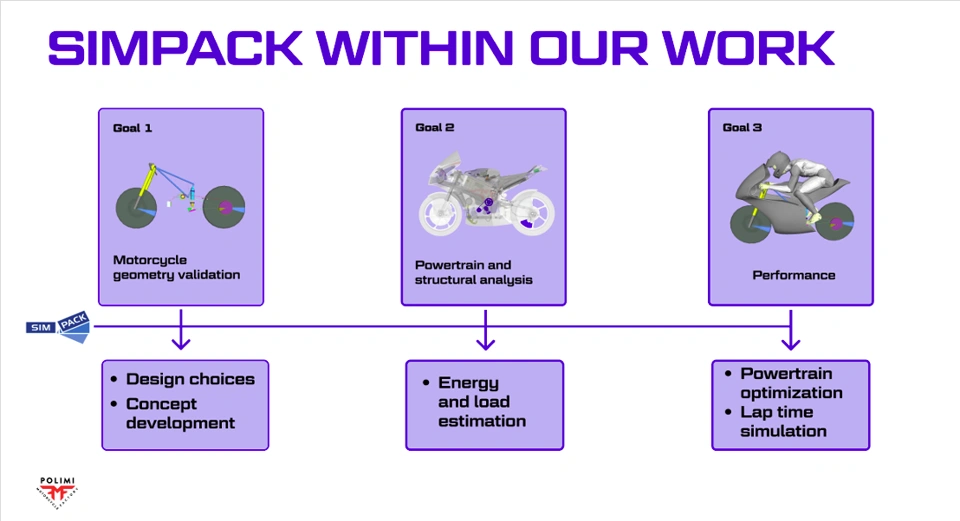

Within this context, an internally developed multibody model of the motorcycles, programmed in Simpack, plays a key role across several stages of the project. It is used for comparative and performance analyses, load estimation for structural component sizing, and integration with in-house electrical and thermal models developed in MATLAB/Simulink to optimize the electric powertrain subassemblies.
The work began with the development of a full multibody model of the 2025 electric prototype, with a focus on accurately representing the main structures, joints, and suspension kinematics. Particular attention was then devoted to modeling the powertrain and transmission system.
Subsequently, the model has been used to perform dynamic analyses under braking and acceleration conditions, comparing simulation results with telemetry data to improve model accuracy. To further improve the simulations, adopting the Simpack Biomotion Motorcycle Rider model has been fundamental, enabling more accurate modeling of rider-vehicle interaction and overall vehicle dynamics.
