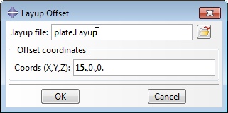

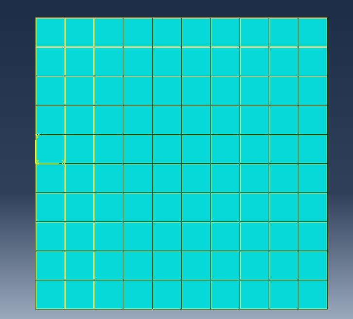

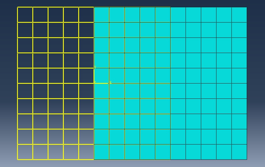

We had a use case where the part geometry and layup file were in different coordinate systems, so the entire layup had to be translated to map correctly. The image below shows a preview of the original layup being mapped to the offset mesh:
The 'Layup Offset'plugin takes the name of a layup file and the required offset coordinates (think of it as a vector translation from the origin):
It writes a new file 'layupname_mod.layup' which can then be mapped onto the offset mesh:

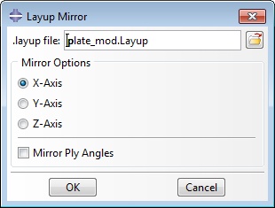

The second plugin mirrors layup files, allowing you to quickly create the other half of a symmetry model. Again, specify the name of the layup file and select the global axis corresponding to the mirror plane normal. You can also select whether to mirror the ply angles or not:
The resulting layup file is named 'layupname_mirror-?-Axis.Layup'.
