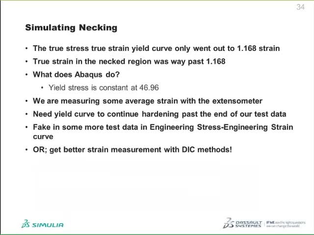

•Simulating Necking

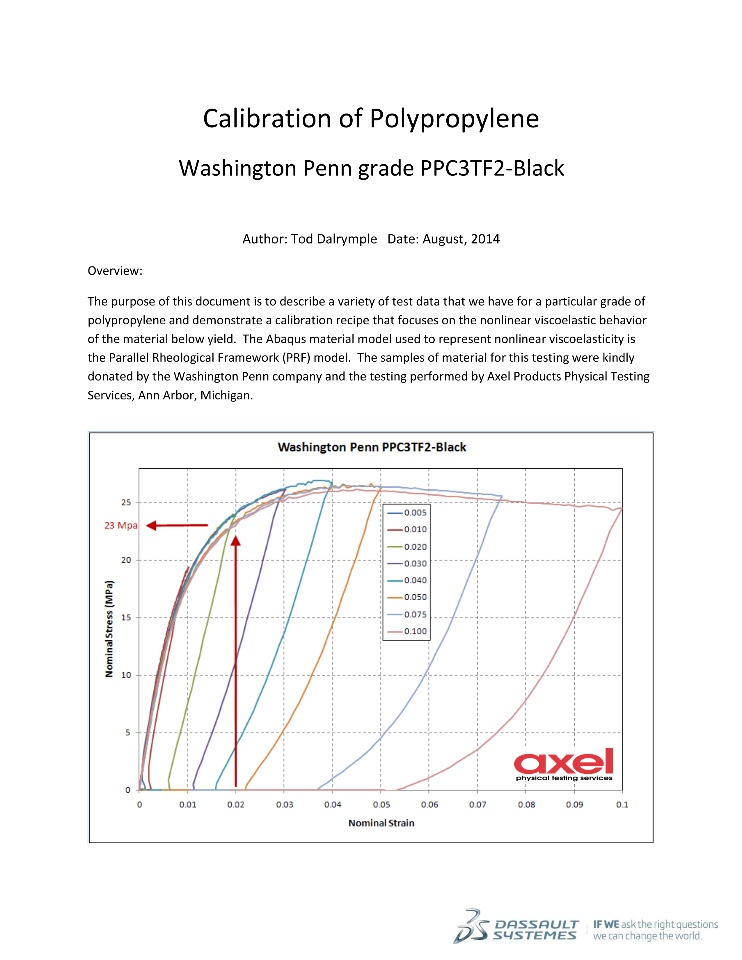

While elastomers are often thought of as nonlinearly elastic, and having viscoelasticity, plastics such nylon, polypropylene, polyethylene, etc.  exhibit elasticity, plasticity and viscous behaviors.  We start the eSeminar looking at a variety of real test data, and then dive into a discussion of determining the yield point in plastics.  The challenge with plastics, as opposed to metals, is there is often viscous behavior early in the stress-strain response that masks the onset of plasticity.   The "Strain Recovery Test" is shown to be a way to begin to delineate the viscous versus the plasticity behaviors.  The final part of the eSeminar describes the use of two advanced material models that can be used when one wants/needs to model both the plasticity and viscous behavior of the polymer.   For the Parallel Rheological Framework (aka PRF) model, we show an Isight calibration for a particular grade of polypropylene.  We also attach to this blog post a document that describes the calibration process in more detail.

Document describing details of Isight calibration of polypropylene material:
