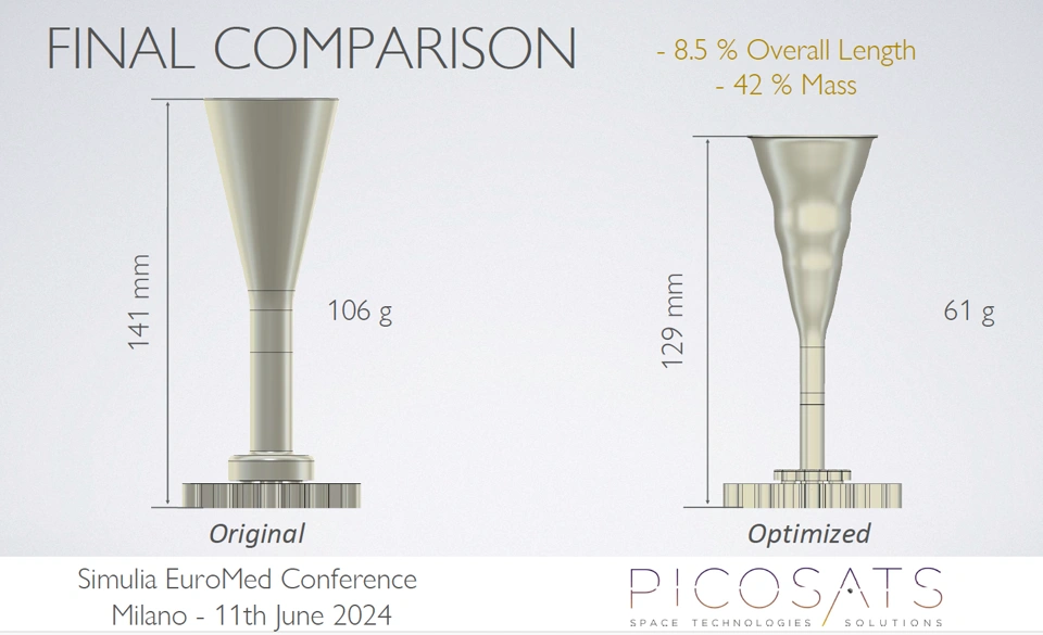

This paper presents the nonparametric optimization of a Q-band horn antenna for CubeSat satellite applications.
The nonparametric optimization software Tosca allows a vast design space to be explored without the constraints imposed by predefined parameters. Instead, allowing the geometry and material properties of the antenna to evolve dynamically, adapting to the desired performance criteria.
Key considerations in the optimization process include gain maximization, sidelobe and axial ratio minimization in the Q-band spectrum.
The results of this research highlight the possibilities offered by the Tosca nonparametric optimizer for the design and development of advanced satellite communication systems. By pushing the boundaries of antenna optimization beyond parametric limits, this approach helps improve the efficiency and reliability of Q-band horn antennas in satellite communication applications.
