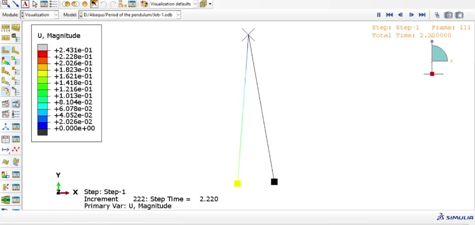

Period of the pendulum using the Abaqus
first, period of the pendulum is calculated using the Analytical Solution, then it will be calculated using the Abaqus software and finally, the results obtained from the Abaqus software will be compared with results of the Analytical Solution
 the initial angle of the pendulum is 10 degrees, the length of pendulum is 0.7 m, and the mass of ball is equal to 2 kg
The period of a pendulum period is the amount of time it takes to make a complete swing, or in other words, The time it takes for the pendulum to return to its original position
The period of the pendulum is equal to 1.68 seconds from Abaqus software
