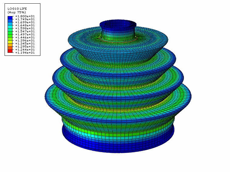

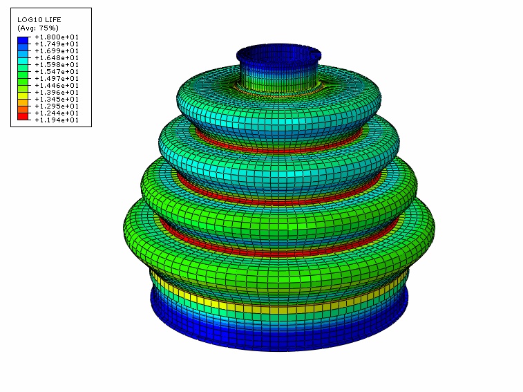

Recently, Endurica’s summer intern ran an optimization analysis on automotive CV joint boots using Abaqus to model the boot in operation, and fe-safe/Rubber to calculate fatigue life. With no previous experience and just a few days of training, he was able to model and analyze CV boots using four materials with different design features (material, fillet radius, wall thickness, and pre-loading in compression or tension). In a matter of weeks he was able to thoroughly explore the CV boot design space for fatigue performance, using numerical simulation of possible changes in material, geometry, and loading. The study will be published soon at Rubbernews.com.
          Worse life: 3.47*10^11                                       Better life :7.08*10^12 cycles
(a cycle is one revolution of the wheel while the wheel is turned 30 degrees in this case).  The life was improved by around  20 times
