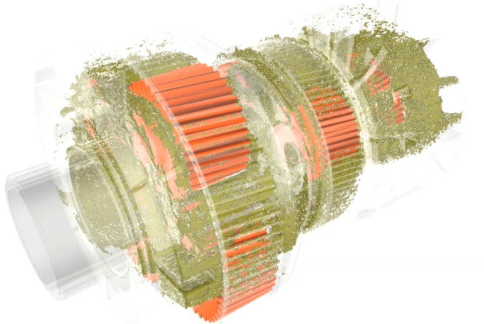

Lubrication simulation of a 5MW wind turbine drivetrain.

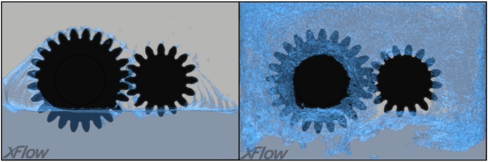

Simulation post-processing allows measuring any KPI, no matter the operating conditions – in this case, at different speeds leading to oil aeration
Numerical simulations can reduce the number of physical tests, providing quantitative predictions for KPIs like wetted area, churning losses or temperature distribution that can be very difficult or impossible to measure experimentally. This cuts development time and costs, and reduces the risk of failure at a late stage when design changes are more expensive.

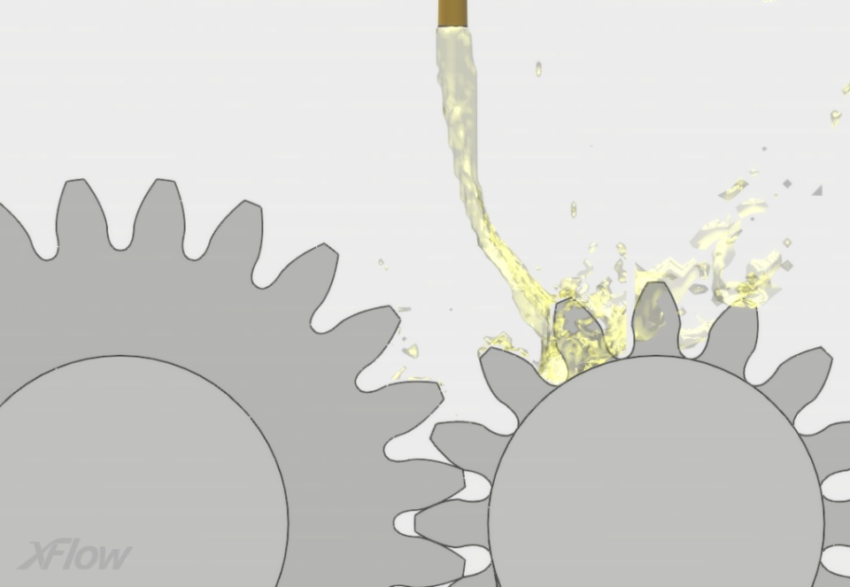

In the case of high-speed industrial gearboxes, using only splash lubrication would lead to extremely high churning losses due to the required oil level and the rotational speed. Therefore, they also include jet lubrication through nozzles pointed at the contacting surfaces. This is another design challenge as centrifugal forces deflect the stream of oil.
Windage effect deflects stream of oil.

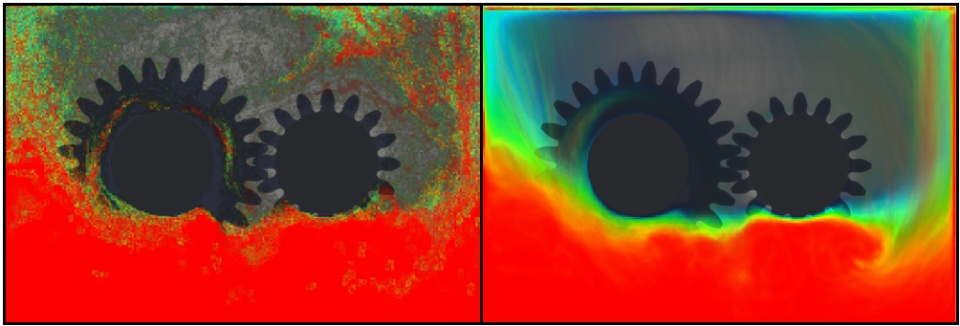

Wetted Regions and Splashing Patterns
A common KPI for any sort of lubrication method is the oil distribution in all operational conditions. This is needed for many reasons: Adjusting oil bath level, optimizing nozzle mass flow and orientation, analyzing thermal convection, etc.
Simulation visualization of averaged fields assists the user with the gearbox analysis in any operational condition.
Even for moderate rotational speed, an experimental measurement of oil distribution requires high-speed cameras and image post-processing due to the high-speed oil splashing. Numerical simulations remove the constraint of fixed camera positions during the experiment, giving more analysis flexibility.

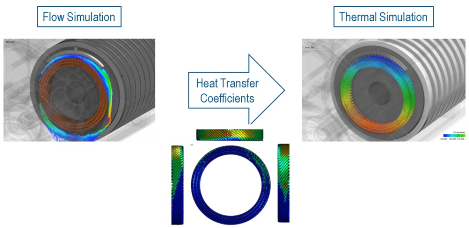

Thermal Analysis of Gearbox Oil Temperature
Gearbox power losses are chiefly transformed into heat, making the use of an appropriate cooling system essential. Otherwise the oil temperature would increase, losing its ideal properties and leading into system failure.
In order to get accurate data under controlled conditions, lubrication experimental tests keep the oil at a constant temperature through oil cooler systems.
Using a similar approach for numerical simulations, it is possible to solve the complex flow field under the assumption of constant temperature in both the flow and the solid rotating and fixed geometries. Once the flow has converged in a matter of seconds, it is possible to use the convective Heat Transfer Coefficients (HTC) to analyze the heating of components.
Fast and accurate thermal analysis by removing the need to solve the slow evolution of temperature, as well as a fast convergence flow.
