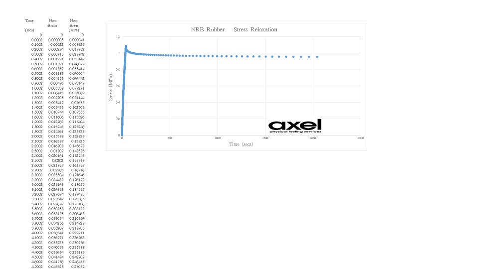

This test data was donated by Axel Physical Testing Services www.axelproducts.com
The material is a Natural Rubber / Butyl mix, so we use the abbreviation "NRB".
The attached Excel file contains three sets of test data all at 23 deg C.
STSR - Simple tension Stress Relaxation

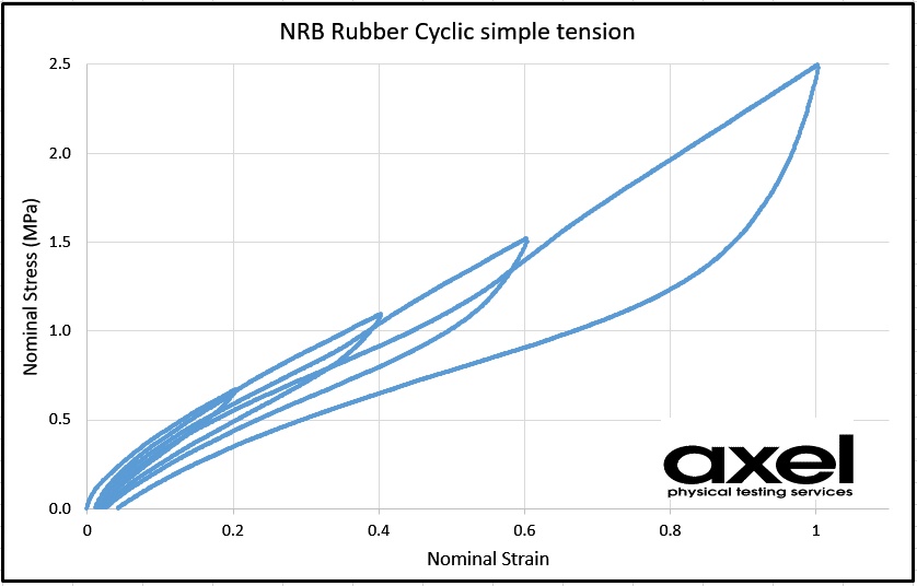

Cyclic data in uniaxial tension

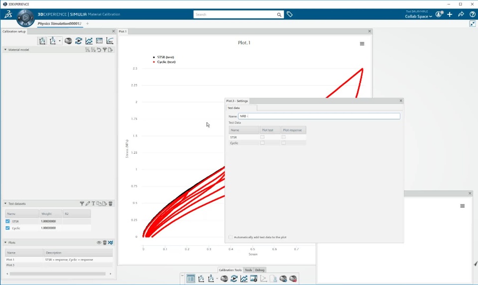

Here is a narrated video showing the calibration of a hyperelastic + Prony + Mullins material model. This video was made using a development version of the calibration app in Feb, 2020. That version of the app resembles the R2020x FD02, FP2014 release (released on April 3, 2020 for on-premise use, but not yet pushed to the public cloud).
