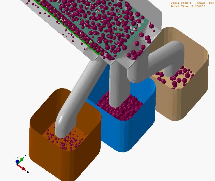

    • Discrete element method (DEM):

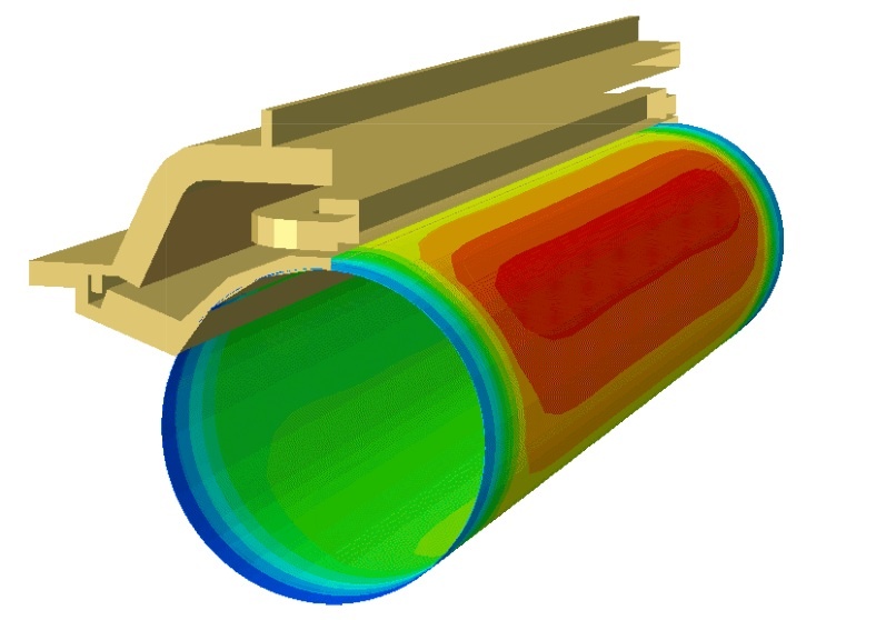

      A new particle method allows you to perform an analysis using the discrete element method (DEM). This method provides a versatile tool for modeling particulate material behavior in LS, EPU, CPG-R, NR, and other industries and is well-suited for particle mixing applications.
    • Nonlinear Viscoelasticity: Improved matches with experimental data are now possible using nonlinear viscoelasticity based on the parallel network approach applicable to LS, CPG-R, and TM industries.
    • Co-simulation between Electromagnetic and Thermal or Stress Analysis procedures:  Direct coupling between an electromagnetic and a thermal or a stress analysis procedure is now supported through the co-simulation capability. This capability allows simulation of problems such as induction heating where the Joule heat output from an electromagnetic analysis drives a thermal analysis, while the temperature output from the thermal analysis affects the electromagnetic fields through temperature-dependent material properties. Drives application in LS and HT industries.
    • Steady-state analysis:  Steady-state flow problems can now be solved directly, eliminating the need to approximate steadystate conditions using a long-duration transient flow simulation.  This enhancement substantially improves overall computational performance in common stead-state CFD simulations and is applicable in all industries.
  • Modeling & Meshing:
    • Hybrid Modeling: Additional modeling flexibility for geometry, native, and orphan meshes to co-exist in the same space.
    • Visualization of gravity waves in Abaqus/Aqua:  You can now visualize and verify the behavior of the water surface under gravity waves in Abaqus/Aqua for EPU and IE industries.
    • Node Dragging: Nodes can be repositioned with a new “dragging” feature.
    • Abaqus/Viewer: extended to visualize preprocessing modeling entities, such as interactions, predefined fields, loads, and more.
  • Performance and Selected Functionality:
    • Substructure generation using the AMS eigensolver:  A new innovative algorithm generating a substructure using the AMS eigensolver is available that significantly improves the performance of a substructure generation procedure of particular importance to TM industry simulation.
    • VCCT Enhancement: now allows the delamination of composite structures to be modeled much more quickly for AD industry.
    • Contact modeling for beams and shells:  Beam-to-surface and beam-to-beam contact can now be modeled with general contact in Abaqus/Standard with particular application in EPU, IE, and LS industries.
    • Adaptive Mesh Refinement for CEL: automatically refines the mesh in models in which large deformation exists.
    • Direct Sparse Solver using Multiple GPGPUs: Support for multiple GPUs in the direct sparse solver provides faster execution on computers with multiple GPU cards.
