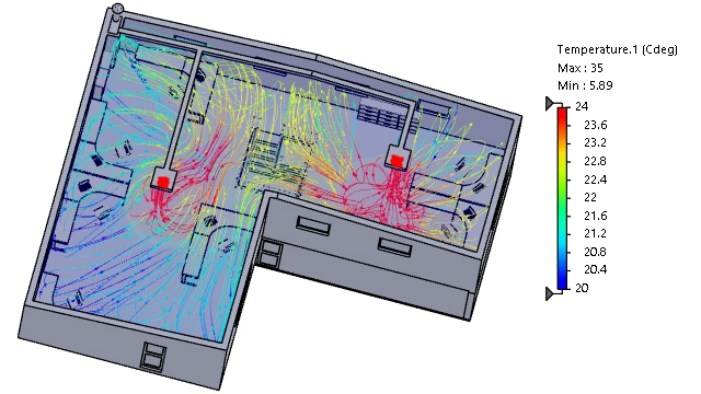

This example, named Thermal Comfort in an Office, guides you through using the 3DEXPERIENCE platform to evaluate the thermal conditions that people experience while in a closed office environment with a working HVAC system. To evaluate these conditions, you use the following apps to define, run, and analyze a steady-state heat transfer simulation:
  • Geometry Idealization Essentials
  • Fluid Model Creation
  • Fluid Scenario Creation
  • Physics Results Explorer
While evaluating the simulation's results, you use criteria to establish what most people deem as comfortable for prolonged exposure. For example, you assume that the optimal temperature range for thermal comfort is 20–24℃.
While defining the simulation model, you learn how to use abstractions to form an interior volume that serves as the fluid space, specify the physics behavior of airflow with thermal and gravity effects, and specify boundary conditions for convective heat transfer scenarios. In addition, you learn how to estimate the power input and efficiency of an HVAC system as well as the heat losses that occur through structural components. You can use what you learn from this example to examine the thermal comfort, wall insulation, and HVAC system efficiency of your own office, home, facility, etc.
