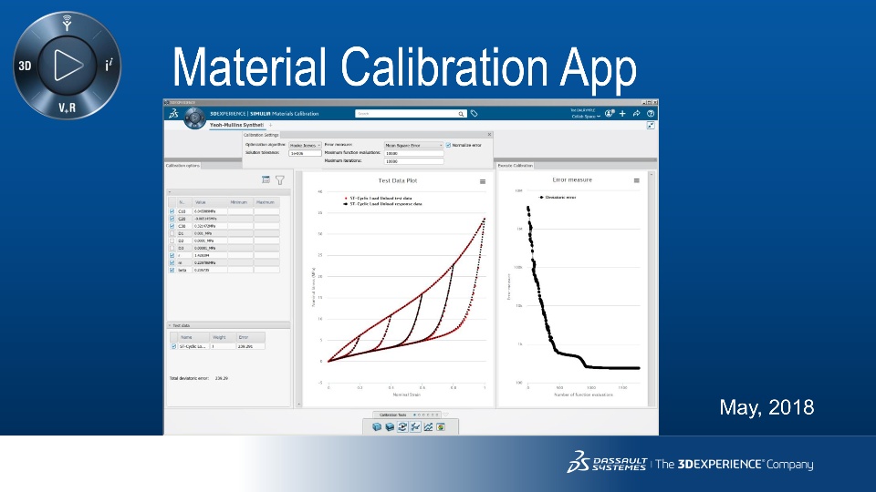

Material Model Calibration Update Slides (as of 06-06-2018) :

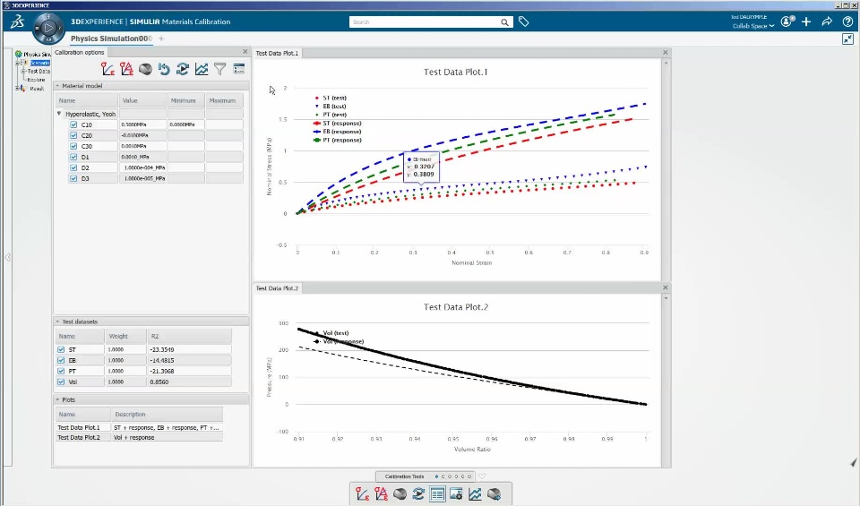

Material Model Calibration Demo #2, add volumetric data, still simple hyperelasticity (13 minutes) :

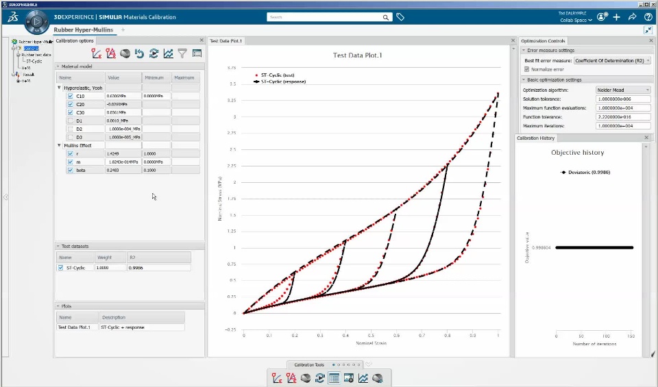

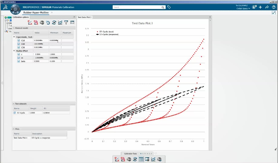

Material Model Calibration Demo #3a, hyperelastic + Mullins material model (13 minutes) :
Material Model Calibration Demo #3b, 3a revisited (5 minutes) :

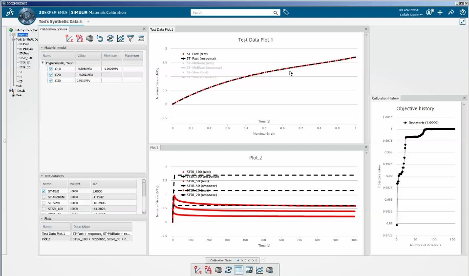

Calibration Demo #4, more types of test data, hyperelastic + Prony series viscoelasticity (14 minutes) :
