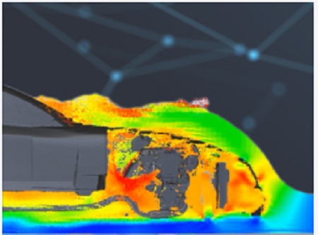

​​​​​​​Today’s products require complex simulation of their real-world behavior under extreme conditions. SIMULIA XFlow allows users to address complicated CFD workflows, reduce physical testing and make better design decisions faster. The 2022 release of XFlow has several new features and improvements to existing features, a few of which are outlined below.
