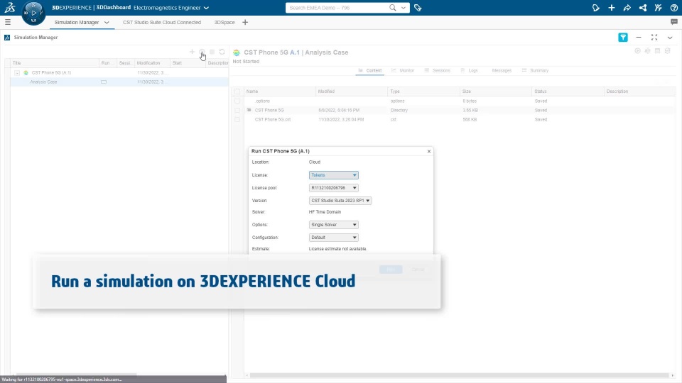

Fully web-based end-to-end support for CST Studio Suite on Cloud:
We are please to introduce support for interactive remote sessions of CST Studio Suite through the Electromagnetics Engineer role on Cloud, enabling customers to build and post process their CST Studio simulations right from their browser. Combined with running and monitoring simulations on Cloud with the Simulation Manager app, the end to end workflow is now fully supported in the web:

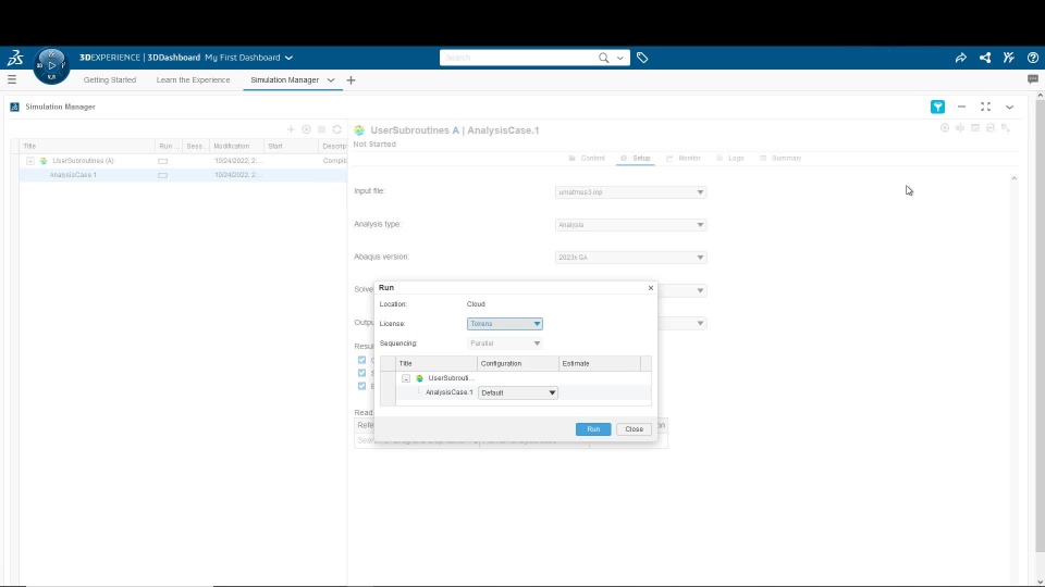

Compiling Abaqus user sub-routines on Cloud:
Users can now upload uncompiled user subroutines to their Abaqus Power'By simulations/analysis cases through the Simulation Manager app available in the All Physics Analyst role on Cloud. Uncompiled user subs will be compiled on the cloud right before starting the solver, ensuring compatibility with the OS/environment used for the solve:

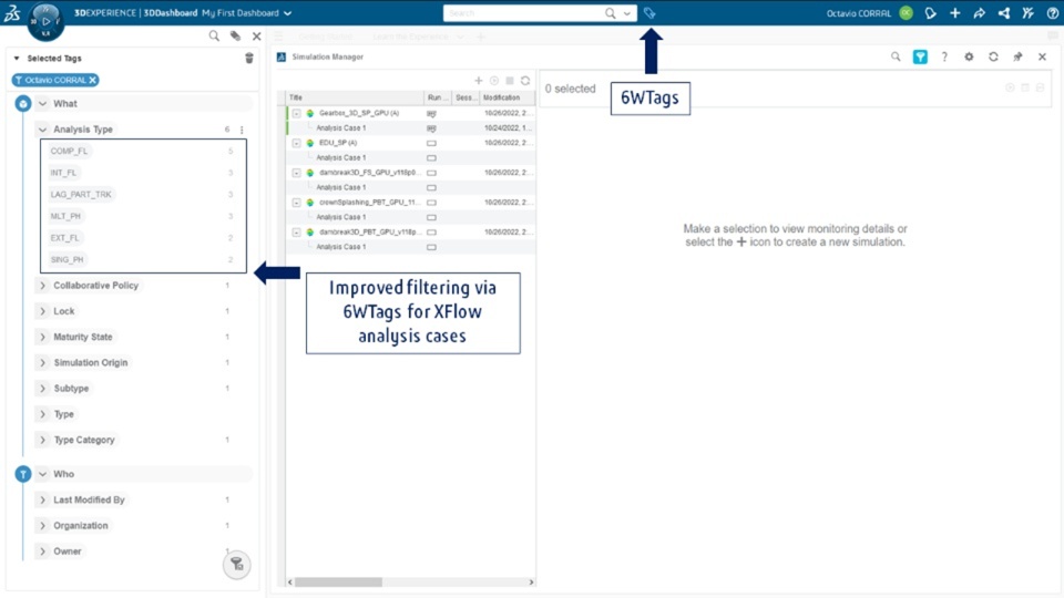

Improved support for CST Studio and XFlow Analysis Cases:
The Simulation Manager app now displays analysis cases created from CST Studio Suite and XFlow clients when saving models to 3DEXPERIENCE. The enhancement includes support for the new analysis case types filtering using 6Wtags:

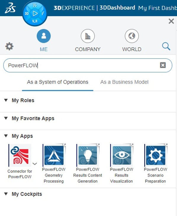

PowerFLOW post processing apps available in the Compass:
It is now possible to instantiate remote sessions of PowerFLOW post processing clients directly from the Compass, using the PowerFLOW Results Visualization (PowerVIZ) and PowerFLOW Results Content Generation (PowerINSIGHT) apps available in the All Physics Analyst role on Cloud (PXK-OC):
