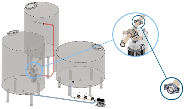

As part of the R2025x GA user assistance, SIMULIA R&D created a 3DEXPERIENCE example that illustrates how to define and run a structural simulation that evaluates the contact pressure between parts of an assembly. In this particular example, the assembly is a clamp that holds together two pipes. Between the pipes, there is a rubber o-ring that is intended to prevent beer (yes, beer 🍺🥰) from leaking between the pipes. Your objective is to determine whether the load that you apply to the bolt (that is, the bolt that holds together the clamp) generates enough contact pressure between the o-ring and the pipes to prevent leakage.
