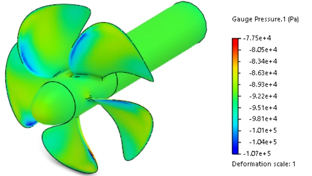

As part of the R2026x FD02 user assistance, SIMULIA R&D created a 3DEXPERIENCE example that teaches you how to use a model of a ship's propeller model to create the surrounding fluid flow volumes and run a transient flow simulation on the 3DEXPERIENCE platform.
While completing this tutorial, you learn how to:
  • Transfer a SOLIDWORKS part to the 3DEXPERIENCE platform as a physical product.
  • Define and extract fluid flow regions for a geometry-based flow volume analysis.
  • Specify common simulation features, such as the multiphase physics domain, the rotating zone, and the boundary conditions.
  • Tune meshing parameters, and generate a mesh for inspection before the full analysis.
  • View and interpret the results of the simulation.
You can apply this type of workflow to your own model and scenario.
