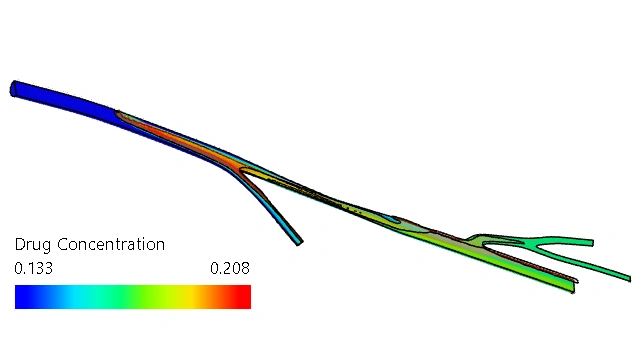

As part of the R2026x FD03 user assistance, SIMULIA R&D created a 3DEXPERIENCE example that teaches you how to simulate drug delivery through an artery by modeling multispecies fluid flow.
While completing this tutorial, you learn how to:
  • Define and extract a fluid flow region for a geometry-based flow volume analysis.
  • Create a physics domain with two liquid species, and assign mass diffusivity values to each species.
  • Analyze the results of the steady-state, internal flow analysis.
  • Plot isosurfaces to visualize the molecular mass fraction of each species.
