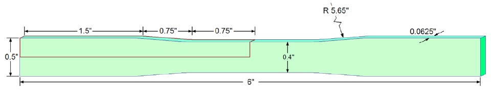

This first workshop tutorial presents the multiscale analysis of a metal matrix composite comprised of silicon carbide fibers in a titanium matrix. The fibers are modeled as linear elastic, however, the titanium matrix is isotropic and viscoplastic. Rather than perform experimental tests to characterize the composite properties with a fiber volume fraction of 33%, the FEAMAC software from NASA Glenn Research Center is used to predict the composite response in a simple dogbone tensile test. The example problem provides a longitudinal tensile test, where the fibers are oriented in the loading direction.
