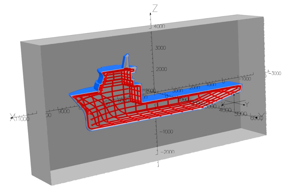

Opera-3d can help designers to simulate and optimize electromagnetic fields around the ship. However, even with the computational power of modern computers it is often not practical to simulate the complete details of a real vessel. A typical case for the finite element analysis approach is to consider/prepare a simplified model of the ship for simulation by de-featuring a CAD model of a real ship or building a representative model from scratch. Even so, meshing of the principal components (hull, decks and bulkheads) is cumbersome due to high aspect ratio of lateral dimensions to the thickness. This is where the modelling capabilities in Opera-3d offer a viable solution: the thin plate boundary condition – a method for finite element mesh construction suitable for magnetic signature simulations. Thin plates with finite thickness are replaced by a two dimensional surface between neighboring free-space volume elements. During equation generation, the surface is expanded to equivalent hexahedral or prism elements, while the free-space elements remain unmodified. This alleviates many of the issues associated with mesh construction in high aspect ratio geometry. The calculation time of the ship’s magnetic field with the thin plate boundary condition method is significantly less compared to the ship model with layers of steel. The other big advantage of using thin plate boundary conditions is the reduced model building and meshing time.
When the degaussing process is performed, the magnetic signature of the vessel is reduced using 3d sets of coils installed onboard. Creating multiple sets of relatively thin coils may significantly slow the analysis if the coils require meshing. This however is usually not necessary and another Opera feature, Biot-Savart conductors, becomes extremely useful. Biot-Savart conductors must be embedded in reduced (scalar or vector) potential (i.e. air regions), but as their fields are calculated analytically the benefit in terms of analysis speed is significant. In the webinar "Modeling Magnetic and Electric Signatures Using SIMULIA Opera," we will discuss practical aspects of building models for degaussing and show results of more complex analysis that includes optimization using a coupled workflow between Opera and SIMULIA Isight.
