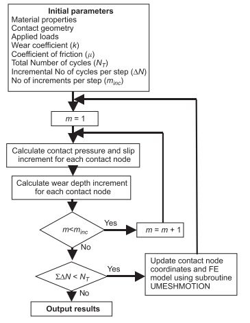

  • The Archard wear law was used in this study
  • The “umeshmotion” subroutine was used to implement wear

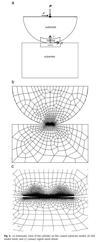

  • Adaptive meshing was used but only for the coating.  The authors did not want to change the coating-substrate interface.
  • The cylinder was the master surface while the flat was the slave surface.
  • The finite sliding contact pair algorithm was selected.
  • Coulomb friction was implemented using Lagrange multipliers.
