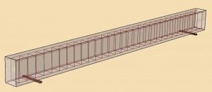

In this example, we subject a reinforced concrete beam of length 6.0 m and having a rectangular cross-section of 0.5 m x 0.3 m to a uniformly distributed load of 33 kN/m. The beam is a simply-supported beam with overhangs as shown in Figure 1. The supports are placed 0.5 m from the ends of the beam. The design of the beam, reinforcement configuration and loading conditions are for illustration purposes only.
Figure 1. A schematic of the reinforced concrete beam. The reinforcing bars and stirrups are embedded into the concrete beam.

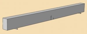

The static analysis shows that the cracking in concrete starts at a load value of about 25.08 kN/m. The DAMAGET output variable for concrete shows values greater than zero starting from this load value. The cracks extend as the applied load increases; however, simultaneously, as damage increases and the material degrades in stiffness, the time increment size used by the analysis reduces. The analysis progresses slowly until the maximum number of increments are reached, which occurs at the applied load value of 25.48 kN/m. The crack pattern at this load value is shown in Figure 2.
Figure 2. Predicted pattern of cracks in the concrete at a load value of 25.48 kN/m. These results are from Abaqus/Standard static analysis. Only a few cracks are seen in the central region of the beam.

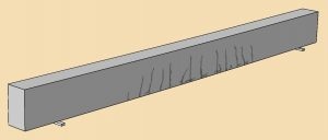

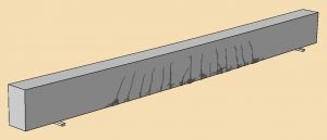

The predicted crack pattern in the concrete at an intermediate load value of 26.4 kN/m is shown in Figure 3. Figure 4 shows the crack pattern at the end of the analysis at the full load of 33 kN/m.
Figure 3. Predicted pattern of cracks in the concrete at an intermediate load value of 26.4 kN/m. Abaqus/Explicit has been used for this analysis. An extensive region in the center span of the beam shows cracks.
Figure 4. The predicted crack pattern in the beam at the end of the analysis at the full-applied load of 33 kN/m. These results are from the Abaqus/Explicit analysis. The beam shows severe cracking in the center-span region.

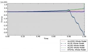

To ensure that the Abaqus/Explicit analysis replicates a quasi-static behavior, we compare the loading time to the natural period of vibration of the beam. The time period of the vibration mode of the beam corresponding to the expected deformed shape is about 0.05 seconds. To ensure a quasi-static analysis, the load application time used for this analysis has been chosen to be about 20 times the natural time period of the beam. Figure 5 shows the computed energy plots after the Abaqus/Explicit analysis, and these confirm that a quasi-static solution has been obtained. The kinetic energy remains small compared to the internal energy, damage dissipation energy, and plastic dissipation energy.
Figure 5. Plots of Damage Dissipation Energy (ALLDMD), Internal Energy (ALLIE), Kinetic Energy (ALLKE), Plastic Dissipation Energy (ALLPD), and Total Energy (ETOTAL) computed from the analysis. The kinetic energy is small compared to the internal and dissipation energies, indicating that a quasi-static solution has been obtained.
The beam used in the example shown here is just a simple structure; however, similar analyses can be done on complex structures to help identify cracking patterns that can then guide the placement of reinforcement.

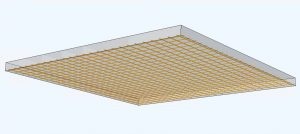

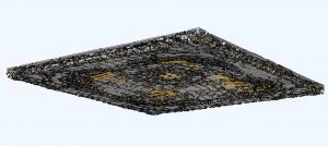

The reinforced concrete slab is placed horizontally. It is fixed on its edges and is subjected to a blast load from below. The slab has dimensions of 5 m x 5 m and a thickness of 0.2 m. Figure 6 shows a schematic of the slab. The blast load originates at a point located 2.5 m below the center of the bottom surface of the slab. The reinforcement configuration and loading conditions in this example are for illustration purposes only.
Abaqus/Explicit is used to predict the deformation and collapse of the slab due to the blast. The concrete damaged plasticity material model in Abaqus is used for this analysis, and reinforcement is defined using embedded element constraints. The slab undergoes severe deformation due to the blast, and several concrete elements in the slab get damaged and fail. The failed elements are automatically removed during the analysis by using the concrete failure option in Abaqus.

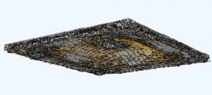

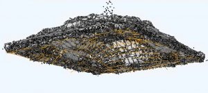

Figure 7 shows the deformed and cracked slab at 0.0125 seconds. Figures 8 and 9 show the cracked slab at 0.025 seconds and 0.05 seconds, respectively. The exposed reinforcing bars can be seen.
Figure 6. A schematic of the reinforced concrete slab.
Figure 7. Deformed and cracked slab at 0.0125 seconds. Exposed reinforcing bars can be seen.
Figure 8. Deformed and cracked slab at 0.025 seconds. Exposed reinforcing bars can be seen.
Figure 9. Deformed and cracked slab at 0.05 seconds. Exposed reinforcing bars can be seen.
