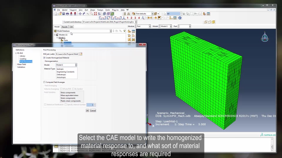

An short demo showing homogenization of a textile unit cell model

In the first step, a fiber-matrix model is used to predict the transversely isotropic elastic response of a unidirectional composite material.  This material response is then used for the tows in a textile unit cell model.  This textile unit cell model is used to obtain the shell section behavior for a thin textile laminate.  Note that this shell section stiffness is based directly on the response of the textile unit cell model with shell-like boundary conditions applied and does not come from laminated plate theory (which assumes that properties do not vary in the plane of the shell – an assumption which may be incongruous with thin textile laminates or honeycomb/lattice-core panels).  This shell section stiffness can then be used to define a shell general section definition in an engineering structure.
 The engineering structure can then be analyzed as normal.  Once that analysis is complete, the shell deformation at some point of interest in the engineering structure can be used to drive the textile unit cell analysis.  This permits the stresses in and behavior of the textile laminate to be examined in detail, permitting an analyst to predict whether any phenomena might occur such as interfacial failure between tows, matrix cracking in a tow, or plasticity in the neat matrix pocket which may not be accounted for in the material response used in the engineering analysis.  Additionally, the strain history from a location in the tow can be used to drive a fiber-matrix unit cell, permitting more detailed analysis of the tow microstructure and prediction of phenomena within the tow such as matrix cracking, fiber failure, or plasticity, all based on the predicted response of the engineering structure.
