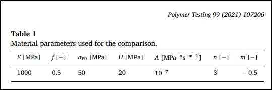

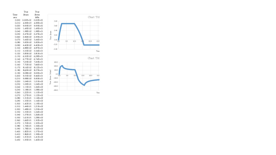

Validation material model (this is not MC-PET) : In the work below, the test data is actually synthetic data created by running the material model shown in Appendix B of the 1st paper.   The material model looks like this:
This uses an older style "creep law", where the units on the "A" parameter are a bit strange.  The "A" parameter can also get very small.
A newer style creep law was added to Abaqus so that the parameters would all have simple units.
To map from the older to the newer style formula, set e0_dot = 1 and then q0 = A ^(1/n)
The exponents "n" and "m" map directly.
This TLVP material model has a lot of parameters to try to determine from just one test.  It would be best to have several different tests to make a better determination.  Since the creep law represents a nonlinear viscous behavior, different tests at different load levels would be a good idea. Also, it would be best to have several tests at different loading rates (strain rates).

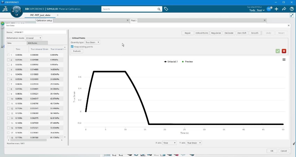

Here is a narrated video of importing the test data and using the test data clean-up tool:

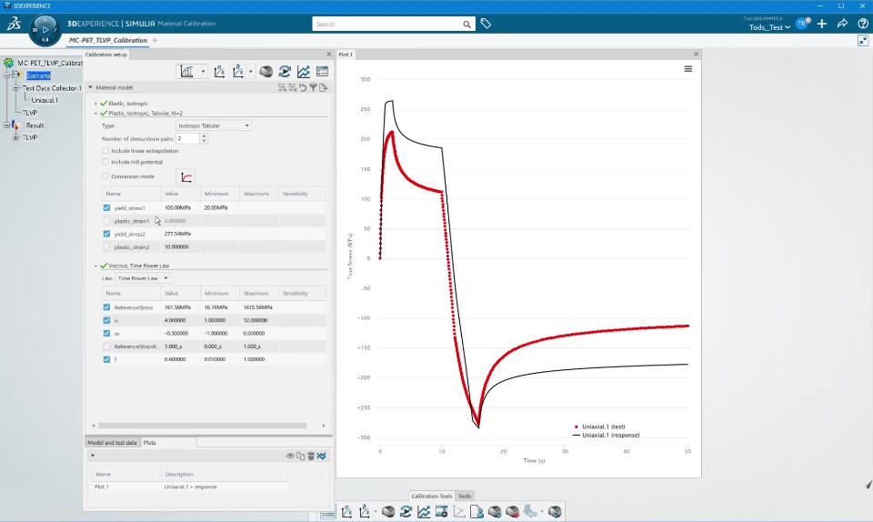

Here is a follow-on narrated video of the calibration process:
One final thing we might do in this case... Since it is synthetic data and we know the correct answer, a nice double check is to type in the right answer. Notice that the R2 error norm value is now 1.000000
Excel file of the synthetic test data:

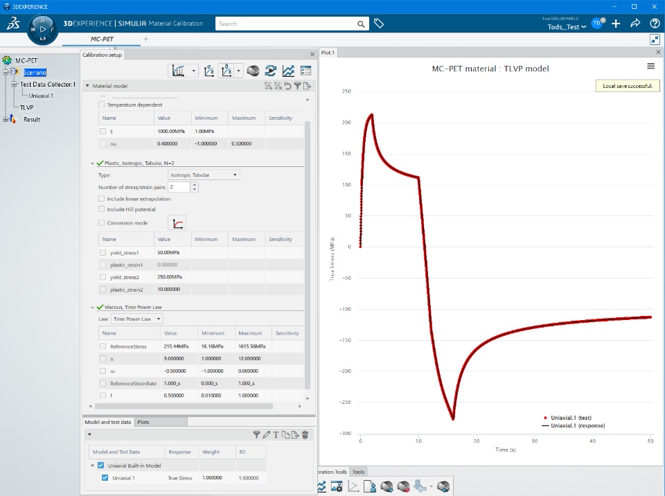

I did not have access to the real test data, so synthetic data was created by running an Abaqus unit-cube model with the material parameters shown in Table 2 of the 1st paper. Here is a video showing the calibration process.
An image at the end of the calibration:
