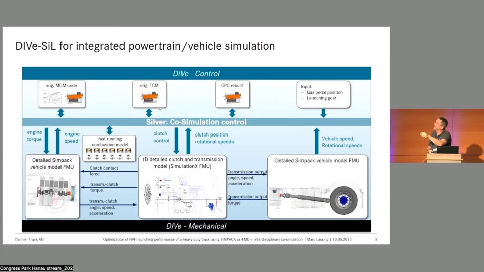

Optimization of NVH launching performance of a heavy-duty truck using SIMPACK as FMU in interdisciplinary co-simulation
Modern trucks today use mainly automated manual transmissions including automated clutch control. Launching behavior is mainly depending on electronic clutch control, as well as various hardware parameters like clutch friction behavior or clutch friction pad stiffness. To optimize the launching behavior regarding NVH and performance a full vehicle model including ECUs for engine, clutch and transmission control was created, using Simpack as FMU inside an in-house co-simulation tool. Hardware parameters and Software versions were evaluated to improve the launching behavior.
Presenter: Marc LÄSSING, Daimler Truck AG
ReplaySlide deck
