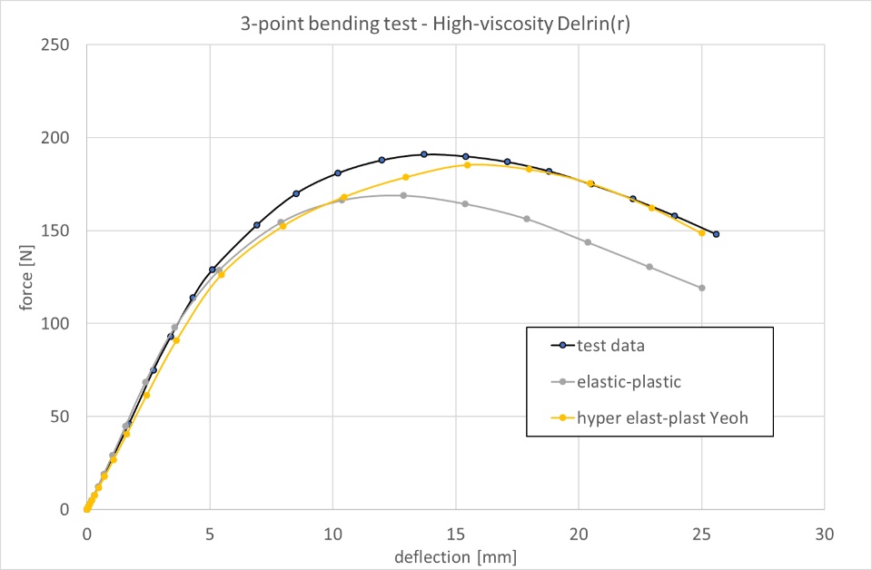

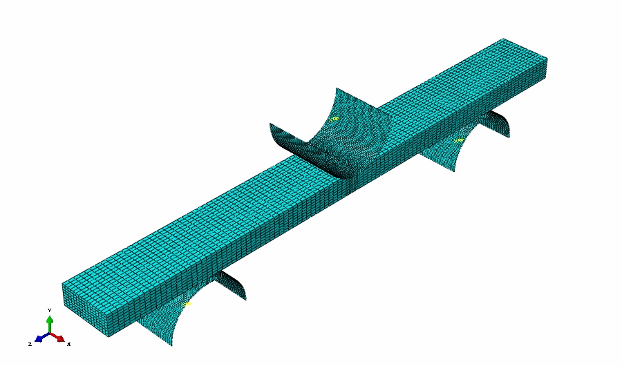

A simple 3-point bending test has been used to show the performance of an elastic-plastic model and a hyperelastic-plastic model for a high-viscosity Delrin(r). The images below show the Abaqus model used and the results of both the test and the simulation results.
Abaqus FEA model of 3-point bending test (from Anders Winkler).
Analysis results of isotropic elastic-plastic and hyperelastic-plastic models
