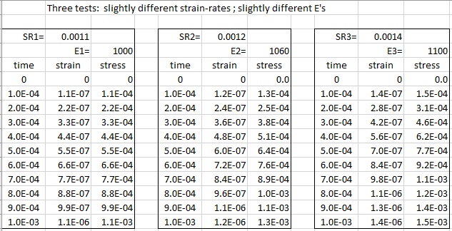

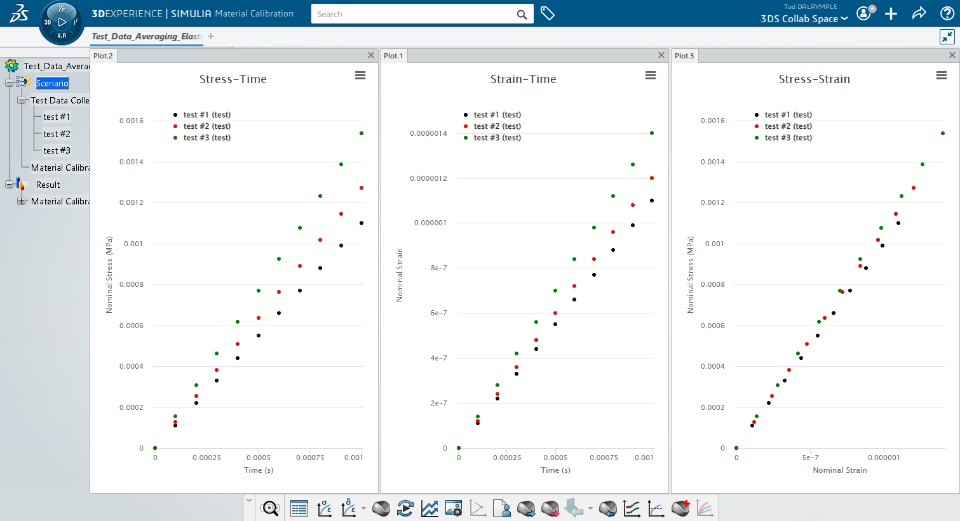

In the Elastic Example 1 the elastic modulus for each test repeat was identical.  In this Example 2, we make the test data slightly more complex by making the elastic modulus have a small variation from test repeat to repeat.  This Example 2 set of test data is attached in the zip file at the bottom of this post, as an Excel file and as a .3dxml file.  The test data is shown in the image below after importing into the calibration app:

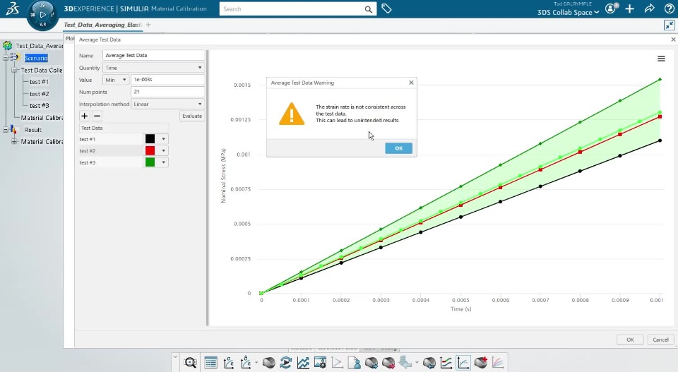

In the video below, we demonstrate using the time-based averaging.

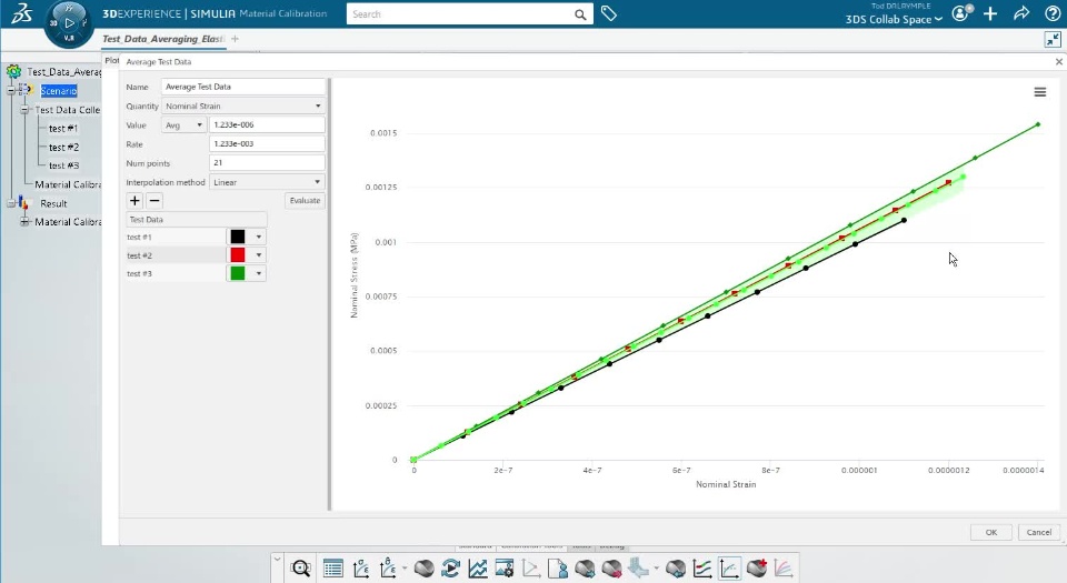

In this 2nd video, we demonstrate using the strain-based averaging:
