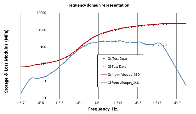

This post is here to store a variety of master curves and speak to a few of the challenges in calibration of material models (Prony series, PRF).  One common attribute of a typical master curve is that it spans many decades in time/frequency, 10 to 20 decades of time/frequency are fairly common.  Along with a broad span of time/frequency (x-axis), master curves typically span many decades of stress/stiffness (y-axis).
Error Norm: RSE  When calibrating master curves, you should select the RSE error norm. I will create a dedicated post to the why behind this.
Optimizer: Differential Evolution and Particle Swarm   We have found both the Differential Evolution and Particle Swarm optimizer to be particularly effective when calibrating master curves
One of my "go-to" references for viscoelasticity is John Ferry's classic book Viscoelastic Properties of Polymers.  Appendix D of his book gives some tabular data for master curves.
Ferry's Appendix D, Table 3, Shear Moduli Master Curve for Polyisobutylene
