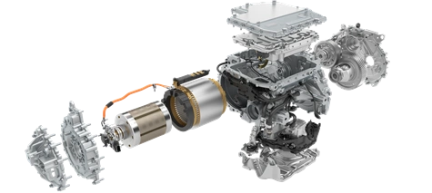

Figure 2: The electric powertrain is the heart of an electric vehicle and its major source of emission. (courtesy of BMW Group Steyr Plant)
ML has solved this problem. Sophisticated sampling strategies exist that work for design spaces of 15 or even 18 dimensions. And with all the cases we have investigated so far, we have never needed more than, say 1000, training samples. This is amazing. And this has worked for many different EMC problems, be it models for EMI filters, for power converters, or for the radiated emission of shielded wires.
