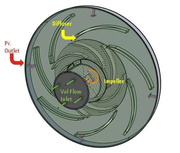

Centrifugal pumps are widely used for pumping low-viscosity fluids such as water, oil and many industrial chemicals. A centrifugal pump consists of a central inlet and a rotating impeller that accelerates the fluid and forces it through the outlet along the outer rim of the pump. Centrifugal pumps also typically include diffusers: fixed vanes inside the pump that slow the fluid and increase pressure while also increasing the uniformity of the flow. The precise geometry of these diffusers affects the performance and efficiency of the pump.

For this reason, diffusers are often used inside the pump. These take the form of a stator with curved vanes arranged around the impeller in the opposite direction. The diffuser must be able to regularize and slow the fluid flow while minimizing turbulent flow effects such as flow separation caused by the interaction of the flow with the diffuser vanes. The performance of the pump depends significantly on the design of the diffuser, impeller & volute, and the interaction between the impeller and diffusor.

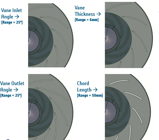

This optimization study focused on the diffuser geometry. There are four parameters to vary here: vane thickness, chord length, inlet angle and outlet angle. The complex interdependencies between these mean that all need to be considered at the same time in the optimization. The simulation was performed using CFD tools on the 3DEXPERIENCE platform.
- Top left: Leading edge angle can define the sharpness in the change of flow direction
- Bottom left: Trailing edge angle can define the extent of change in flow direction
- Top right: Thickness of a vane can define the pinching or expansion of the flow
- Bottom right: Chord or the curved length of the vane can play an important role in flow separation

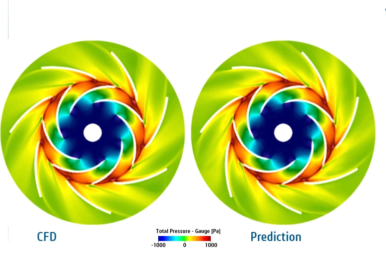

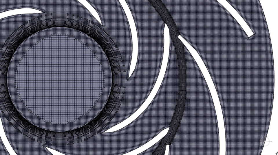

Simulating every possible combination of these parameters with full computational fluid dynamics (CFD) would be prohibitively time consuming. One-dimensional simulations are sometimes used instead to reduce the computational requirements, but these give poor results. Instead, we turned to machine learning (ML). A surrogate AI model can be trained on a sample of full CFD simulation results to replicate the behavior of flows within the pump with different parameters. The resulting model was then validated against further simulations and physical tests and showed excellent agreement with both the full simulation data and the measured data.
The trained AI model was able to provide results, within 2% of the CFD data, for any combination of parameters within the specified range in a matter of minutes. This gives engineers rapid feedback about the impact of a design change, allowing them to consider large numbers of scenarios to accelerate design decisions. With design exploration powered by this machine learning model, engineers could quickly find a trade-off that best meets their design requirements.
