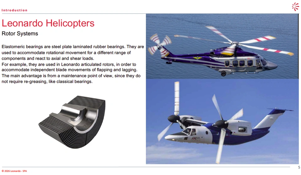

The aim of this presentation is to show the methodology used for a Dynamic Implicit Analysis applied to the Operational Shock loading condition, defined by RTCA/DO-160G, applied to an elastomeric bearing.
