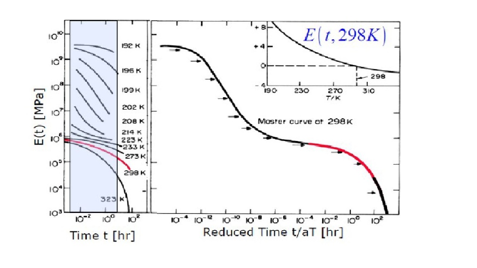

You may be familiar with the WLF equation and Time-Temperature Superposition (TTS). But did you know Williams, Landel & Ferry justified their famous equation with the theory of Free Volume? The idea was that open spaces between polymer chains drive the material’s viscoelasticity. Modulus is a function of time and given sufficient time under load, Free Volume opens up, softening the material. Increasing temperature accelerates molecular motion and therefore accelerates the process, justifying horizontal shifting.
It stands to reason that other state variables that affect free volume should also reduce time. Indeed, environmental and mechanical deformation effects on Free Volume have been developed in the technical literature for decades:
