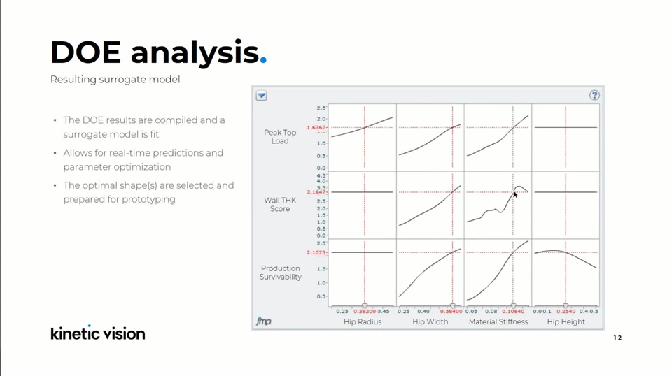

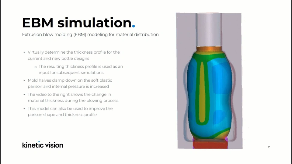

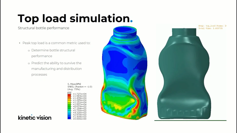

Kinetic Vision will present a study that demonstrates the effectiveness of a streamlined product development process that integrates computer-aided design (CAD), digital thickness prediction, design of experiments (DOE), 3D printing, and manufacturing line testing. By leveraging these tools, we were able to rapidly design, optimize, and manufacture a new bottle design.
First, a parametric CAD model of the bottle was created in 3DX, allowing for precise control over the dimensions and shape of the product. Next, a digital thickness prediction method was used to generate accurate thickness models for all CAD designs. To identify the most promising designs, a DOE was executed using Process Composer covering a design space of geometry and material properties. The top three bottle designs were selected for further evaluation.

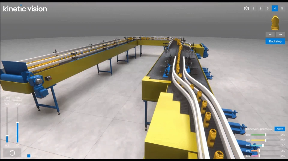

Physical prototypes of each top design were 3D printed with realistic thickness distributions.  The 3D printing technology used creates bottles that physically behave similarly to the mass-produced EBM bottles.  The 3D printed bottles were physically tested on the manufacturing line to ensure their compatibility with the production process
The integration of CAD, digital thickness prediction, DOE, 3D printing, and manufacturing line testing proved to be an efficient and effective approach to product development. This digital-first method reduced the time to market by roughly 50% and the prototyping cost by 90%.
