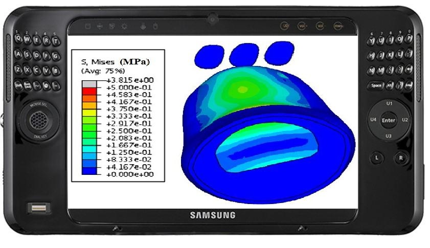

There is good news for those of us with "fat finger syndrome" as engineers at Samsung used Abaqus from SIMULIA to develop finite element models of both a human fingertip and a device key to simulate user input and identify the variables that lead to typos. By utilizing a Python script in Abaqus, the engineers were able to automate a number of their tasks to reach a solution in a timely manner. The result: a keyboard layout which significantly reduced the amount of error from 35% to 7% in the user’s intended input.
