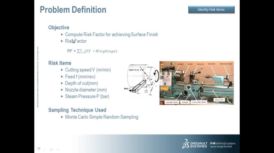

In the attached presentation made by Yogesh UKE,  he explains how Isight can help in reliability study. I hope you find this useful.
