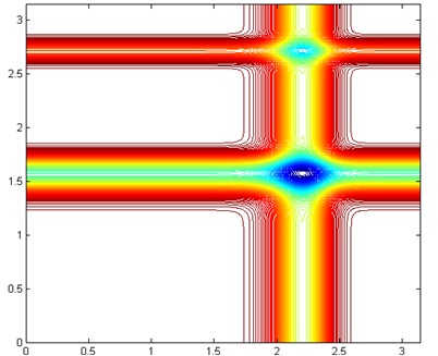

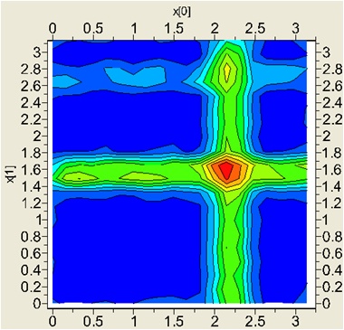

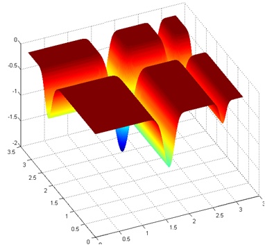

Kriging is  one of the various techniques available in Isight to create surrogate models . This technique is especially suitable to approximate highly non-linear functions, like shown below. The left image shows the function, middle the  actual contour and the right showing the kriging approximation of the function.
