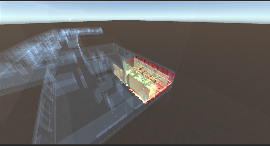

This study was made using PowerFLOW and Dymola, and focuses on our own "Metal" Building in Dassault Systeme's HQ campus located in Velizy, France. The transient 3D CFD results are coupled to the system representation of the HVAC, to predict time varying comfort, and energy consumption, over a full day.
The results available online show:

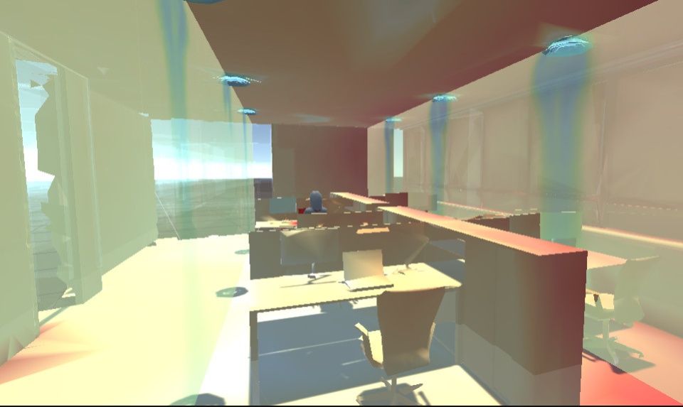

  • The thermal distribution inside the office room as a whole, and under the vents.
  • The local changes in temperature with sun movement - in the east side of the office the temperature will be higher in the morning due to sun positioned there. As the sun moves to the other side, temperatures in the east side decrease under reduced solar load, whilst west side increases.
