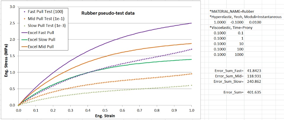

The "pseudo-test data" was generated by running a series of Abaqus unit-cube models with different types of loading.  All the pseudo-test data was generated using the same Yeoh+Prony material model. This underlying Yeoh+Prony model was a reasonable elastomer material model generated from some test data taken during one of our elastomer classes at Axel Products.  This material model is fully incompressible. There is a single zip file attached which contains all the files for this case.
This image is also included in the zip file (Excel_Prototype_Yeoh_Prony_5gs_Start.png).  The pseudo-test data is shown in dots, and the math stress response is shown with lines.  This image shows the starting guess for the Yeoh+Prony model.
There is an attached zip file named "Pseudo-test_Data.zip" that contains 3 .zmf Isight model files, the Excel file, and a few other images.  The reason for 3 .zmf files is because we have run this case with the Hooke-Jeeves optimizer, but set the number of iterations to 1000, then 2000, then 3000.  These 3 cases run in about 3 minutes, 5 minutes, and 8 minutes on my Win7 laptop. One of the images in the zip file shows the errors produced when the known answer is entered, see file named Yeoh_Prony_Prototype_Cal2_test-with-right-answer.png   In all of these cases, we have designated the Yeoh parameters, C10, C20, C30 and the 5 Prony g terms as design variables.  The Prony tau terms remain fixed.
