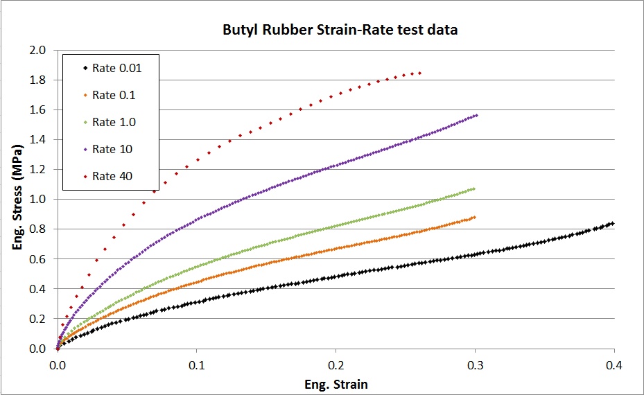

About a decade ago, we started to struggle with helping people interested in other applications, especially where the time frame of interest was much shorter.  At short time frames in drop testing and crash applications, there were no tools available to us for calibrating a Hyper+Prony material model in a simultaneous and integrated fashion from test data such as a family of rate curves (shown in the image above, and posted in Butyl Rubber Test Data).  Our struggles led us to try to accomplish testing that would fit into our available calibration tools, see the post:  Hyper-visco rubber material models in Abaqus.  As the Isight optimization software became part of the SIMULIA portfolio, another solution approach was to run reverse engineering optimizations using an Abaqus unit-cube single element model with the hyperelastic+Prony series material model.  The downside to this approach is that it can be quite slow owing to the hundreds and hundreds of simulation runs involved.
