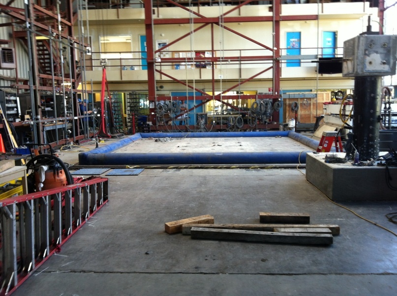

The state-of-the-art six degree of freedom shake table at the Richmond Field Station testing facility of the Pacific Earthquake Engineering Research Center (PEER), University of California, Berkeley

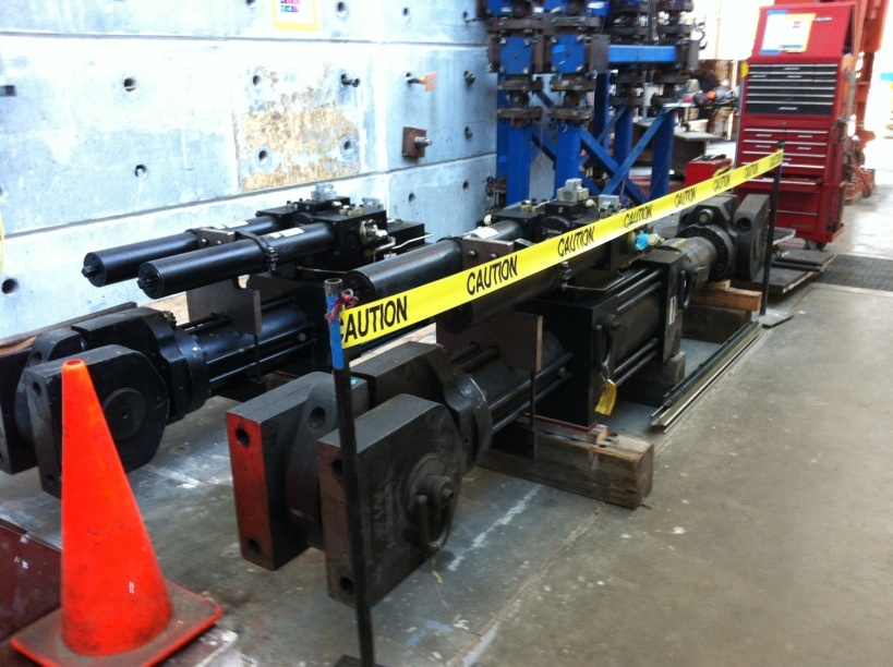

Actuators used for implementing hybrid simulations in the laboratory
Hybrid simulation can be considered as a conventional finite element analysis where physical models of the some portions of the structure are embedded in the numerical model. The overall simulation is controlled by a hybrid engine that applies the load history, having the physical module updating the analytical module at every increment, and vice-versa. Apart from giving highly realistic and accurate overall results for large structures while keeping the costs to a sustainable level, real-time hybrid-testing captures the dynamic and strain rate effects unlike quasi-static experimental tests. Also, unlike the shake-table experimental tests, hybrid testing is not limited by the size of the shake table as it engages hydraulic actuators and data acquisition systems to transfer the forces and reactions exchanged between the analytical and the experimental modules.
