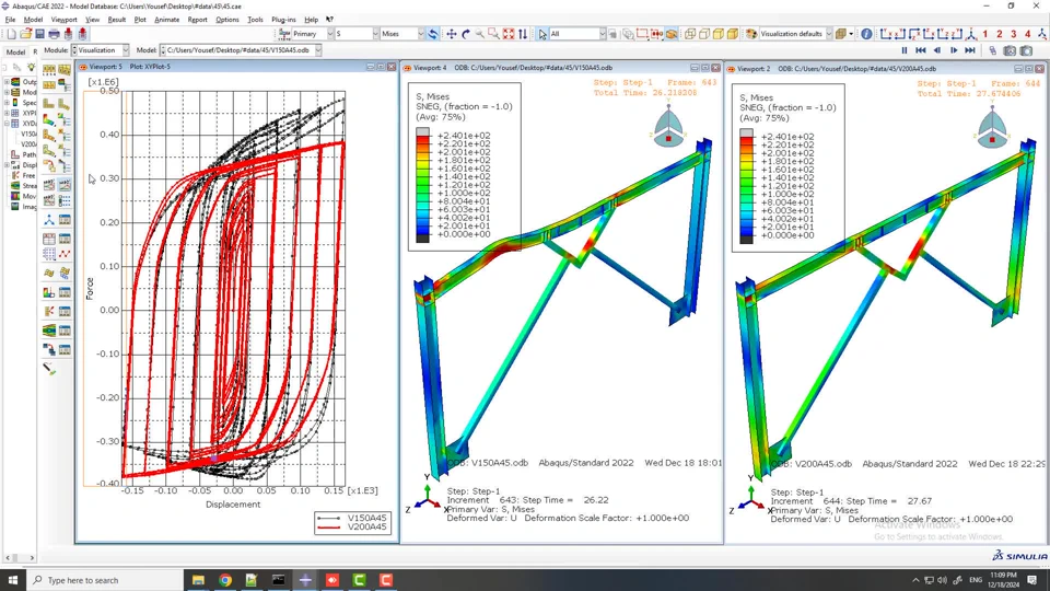

Hysteresis Loading of a V-Shaped Damper: Simulation and Hysteresis Analysis in Abaqus
We all know that laboratory experiments can be a bit like chasing after a runaway shopping cart, challenging and time-consuming 😅. So, why not let Abaqus lend a hand? With its powerful simulation capabilities, it’s like having a super-smart lab assistant that never takes a coffee break ☕👨‍🔬.
In this project, we put a V-shaped damper to the test under seismic loads 🌪️. We simulated two different configurations, one with a 150 mm and another with a 200 mm distance between the beam ends of the V-shape damper. And the best part? The Abaqus model file is attached for you to play around with! 🖥️🔧
For more details, Abaqus documentation is your friend 📚. And feel free to drop any thoughts, questions comments below! 😄
