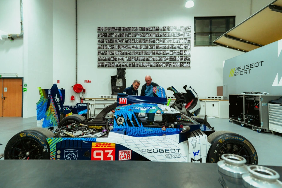

So, first, PEUGEOT 9×8 is built on the the LMH regulation, which is very open regarding what it allows for. The car’s design and shape are not as constrained as in other categories and other formulas, which gives a lot of freedom to the car’s design.
In our Peugeot perspective, we use that advantage to try to embed many of the aesthetic codes from the Peugeot brand, so that everyone can look at our race car and think about the Peugeot road cars, which was very important for us.

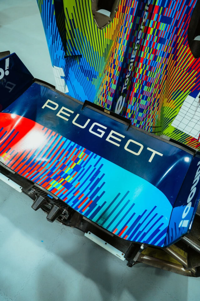

And that’s thanks to the regulation that is very open on the car design, for the car look. As for the 2024 car, the most significant visual change is that we added the rear wing to the car. So, we changed the aerodynamic concept of the car to try to match the new tire dimensions on the car. So, from a non-expert eye, I would say the most significant difference in the 2024 car is that we now have a rear wing with a different aerodynamic package.
Is that what has made the most aerodynamic impact on the car?
Yes. Correct.

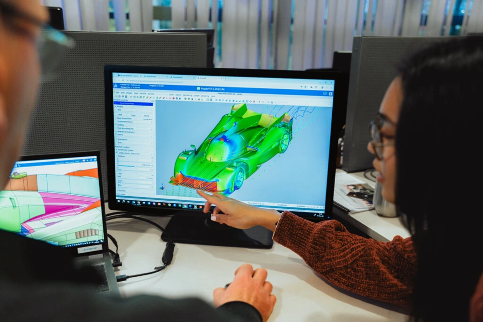

How did virtual design and testing differ from wind tunnel and physical testing?
Well, virtual design has, overall, a much quicker turnover, and it’s also cheaper. In wind tunnel and physical testing, you need to develop the shapes. You need to design the parts properly for mockup parts or full-scale parts.
You need to have a design phase and then a production phase, which usually involves some tooling, which generally takes up to six to ten weeks, depending on the part itself. Then you go to testing, which is another week. Overall, the turnover is more than two months, two to three months from the idea to the physical test, whereas, with the virtual design and CFD testing, you can turn around ideas from your concepts and ideas to results within a week, so much quicker and also much cheaper.
How does moving simulation to earlier in the design process affect the overall outcome, and what are the benefits?
Simulation at the very early stage of the design process is critical because it helps with sorting out concepts. You can be very open at the beginning on concepts that look very different.
You would not be able to physically test all of those concepts because they are too different. They involve too many other models, whereas, with the simulation process, you can be much more open on the options you have at the beginning of the project, which helps you with making sure you’ve actually looked at every single opportunity of design and not just some minor improvements of existing known designs.
How does moving simulation earlier help design engineers gain access to aerodynamics expertise they otherwise wouldn’t have?
Well, as explained, they can look at very different things. So technically, from a design perspective, shapes are very different. That’s one thing. So it’s a much broader view of the potential, and then second, with the simulation, they can access the insights of the generated results.
So it’s not only the overall results they will tell, or that a shape is working overall; it creates that effect, or that one is better than the other. But here, they have access to a much more detailed understanding of what it does and why it does it.
They can look physically at the flow structure around the parts, which would help them understand the physical phenomenon behind the results and, therefore, will be very important and helpful to give them the following ideas to move on to the next concept.
So, it helps understand the details of the physical problems and physical solutions and helps generate ideas for the next concept.
