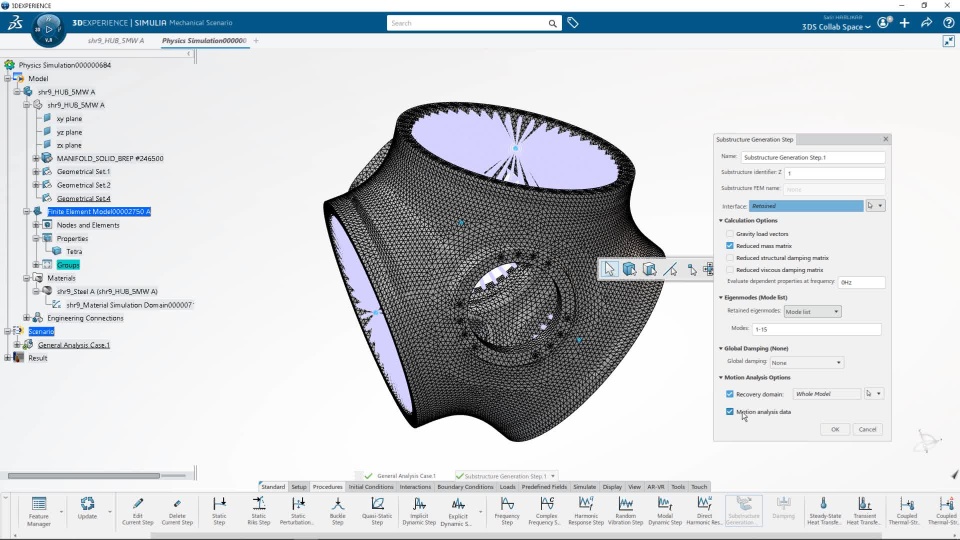

Did you know that you can now generate a Motion/MBS ready FEA substructure on the 3DEXPERIENCE platform and export the generated data as Simpack .fbi file?
Well, now you can! In 3DEXPERIENCE R2022x FD01this feature was enabled thanks to the structures team with @SD.
BTW, with R2022x FD01, it is also possible to import any .fbi file into the 3DEXPERIENCE platform.
Watch how it’s done: the demo video, created by @SH, showcases the process from substructure generation through export to usage in Simpack on the example of a wind turbine propeller hub:
Of course, this is not restricted to just the shown application but can be used for any flexible body topic.
All you need is to have the Structural Analysis Engineer (SYE) role to generate and export the substructure.
