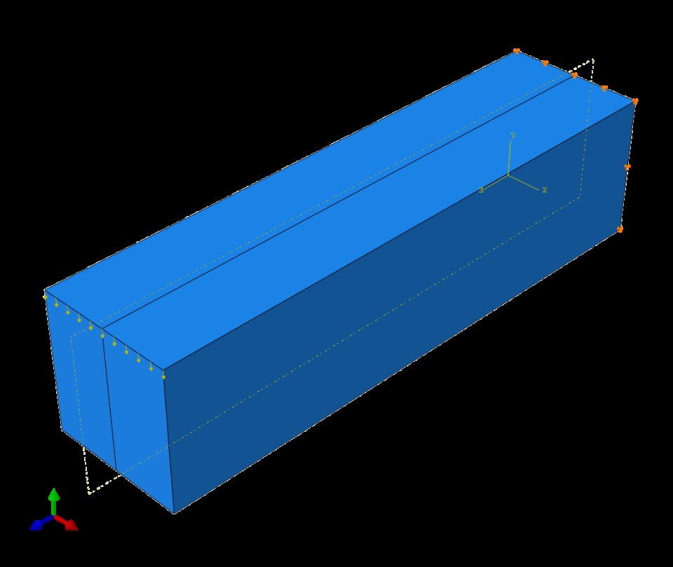

Consider the example of a cantilever beam loaded at the tip with a 100 lb force as shown below.
Optimization definition:
Minimize (compliance)
Subject to: Vfinal=0.7*Vinitial

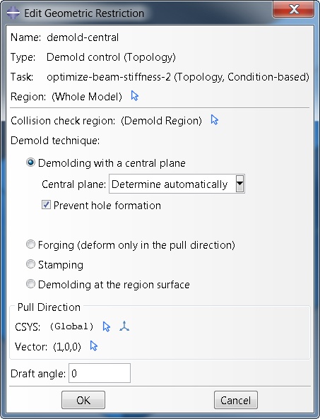

Demold control geometric restriction:

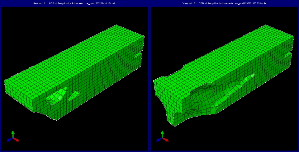

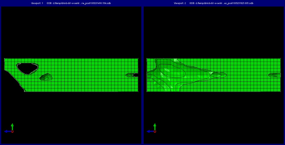

Here the demold control geometric restriction is defined on the whole model. During manufacturing the part will be pulled out of the mold in x direction. Note that the option 'Prevent hole formation' is selected. Let’s look at the results with and without this option.
Isometric view:
Front view:
Note that we recommend running the optimization for at least 15 design cycles while using controller based topology optimization. In this example we are looking at the results for design cycle 5.
